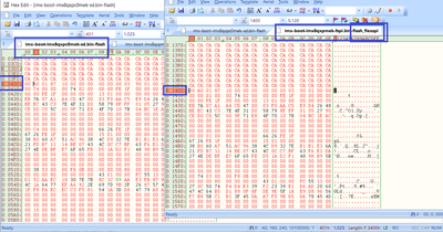

Ok, I have signed "flash" (SD card or USB) target of "imx-mkimage" because that process well described in documentation, and it works - ahab_status prints no security events (OTG USB boot through UUU).
But I found that can`t sign "flash_flexspi" target of "imx-mkimage" using the same CSF (for "flash" target):
スポイラ
[ERROR] CST: Offsets are not consistent with the input binary to be signed
But offset in CSF correct - they are from imx-mkimage output.

How to sign "flash_flexspi" image for iMX8QXP C0?

Please add spi header size
2,985件の閲覧回数
MistX
You mean to add to CSF offsets the size of imx-mkimage/iMX8QX/imx-fspi-header.bin (1536 bytes) ?
So if I have CSF:
[Authenticate Data]
# Output of mkimage
File = "flash.bin"
# Offsets = Container_header Signature_block (printed out by mkimage)
Offsets = 0x400 0x590
I should change offsets to 0xA00 0xB90 respectively?
2,976件の閲覧回数
BiyongSUN
4096
2,970件の閲覧回数
MistX
GREAT THANKS, BiyongSUN!
