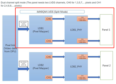

How to setup lvds dual split mode on imx8QMax
2,458 Views
albin_huang
Hardware: I.MX8quadMax MEK
Software: imx-automotive-11.0.0_2.5.0
TFT-Panel: 12.3inch, 1920*720  2 channel lvds, Dual channel split mode (The panel needs two LVDS channels, CH0 for 1,3,5,7,... pixels and CH1 for 2,4,6,8,... pixels):
As I refer to 'https://community.nxp.com/t5/i-MX-Processors-Knowledge-Base/IMX8QM-LVDS-mirror-dual-mode-reference-p...

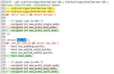

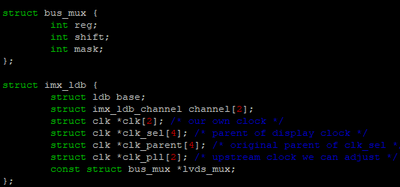

 0001-iMX8QM-LVDS-add-mirror-dual-mode-support.patch.zip ,The patch not match with my downloaded code, especially in the 'drivers/gpu/drm/imx/imx-ldb.c',
below it my downloaded code,'nxp-opensource/kernel_imx/drivers/gpu/drm/imx'
How can I find the way to implement the theme?

Please refer :arch/arm64/boot/dts/freescale/imx8qm-mek-jdi-wuxga-lvds1-panel.dtsi
Add "fsl,dual-channel" property.
