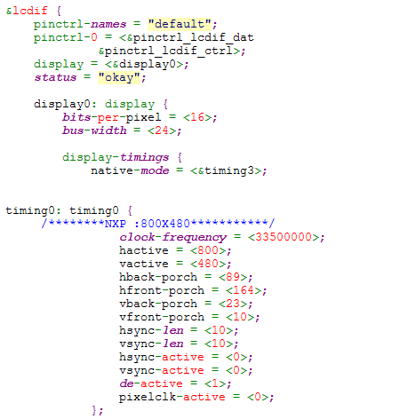

Recently in the study of imx6ul, found that the work of MPU Mode LCD, but my VGA in this mode can not work. So who can tell me how to modify the DOTCLK model, thank you!

Thank you for your answer.But my LCD is working properly, the case then remove the HS VS signal. We call this approach is DE model, but what we need is the HV mode. Is DOTCLK Interface. It includes the VSYNC, HSYNC, DOTCLK and (optional) ENABLE signals. You can test under official imx6ul NXP development board is no VS signal, HS is not corresponding.

one can look at hsync-active,vsync-active in &lcdif {
linux-2.6-imx.git - Freescale i.MX Linux Tree
then add timings for syncs using as example lvds:
https://community.freescale.com/thread/373763
~igor

     You just testing imx6ul development board VS HS, maybe you know what I want it.Here is my lcd parameter settings:
then VS is no signal, VS and HS signals are not received my LCD also can display.What I need is VS HS DE CLK model should work, not the work is only DE CLK
