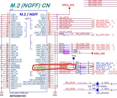

My platform is Linux on i.mx8mp-evk.
I am currently executing:
$echo 38 > /sys/class/gpio/export
$echo out > /sys/class/gpio/gpio38/direction
I can successfully control M.2's pin 56, W_DISABLE1, which is PCIe_nDIS,
Now, I want to control BT disable, which is M.2's pin 54, W_DISABLE2.
Which GPIO pin should I set?
Thanks!

I had tried to execoute gpioset EXP_P0_7 , but it shows
Then I tried to execute
$ echo 503 > /sys/class/gpio/export
$ echo out > /sys/class/gpio/gpio503/direction
$ echo 1 > /sys/class/gpio/gpio503/value
$ echo 0 > /sys/class/gpio/gpio503/value
I measured the voltage of EXP_P0_7 and found that it changes, but TP39 always remains at 0.
Does this mean that M.2 pin 54 has been successfully configured?
Or do I need to solder TP39 and EXP_P0_7 together?
Thanks!
CH

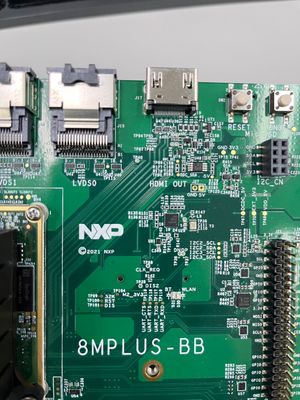

Yes, you have to solder the resistor "R142", if you see in the schematic the resistor "R142" is not soldered, in consequence, the iMX pin is not connected to the TEST POINT.
Best Regards!
Chavira

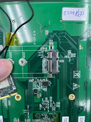

ChChang
Hi Chavira
My i.mx8mp-evk is Rev B2 ,
Do I just need to solder the R142 resistor? How many ohms?
Does R422 not require a resistor to be soldered?
Thanks!
CH

According to the Schematic, the value of Resistor R142 is 0 Ohm.
Watching the datasheet of the wifi module I noticed that is not the correct pin to turn off the wifi module pin 56 of the m.2 connector is the correct one to turn off the wifi module.
https://www.azurewave.com/img/nxp/AW-CM276MA-PUR_DS_B3_H_STD.pdf
On our device tree is defined as a regulator
https://github.com/nxp-imx/linux-imx/blob/lf-6.1.y/arch/arm64/boot/dts/freescale/imx8mp-evk.dts#L66
If you want to control manually the wifi module you should change the device tree and control it like gpio.

ChChang
Hi Chavira
My BSP version is L5.15-kirkstone
I also tried directly connecting EXP_P0_7 to TP39 with a wire, but it doesn't affect BT working.
Can only soldering R142 work?
Thanks for yor reply!
CH
