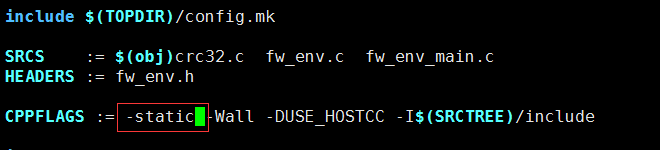

chenqigan_usr
Dear Qiulong Li:
you can compiled fw_printenv with gcc -static option.
eg:
modify $(UBOOT_PATH_TOP)/tools/env/Makefile
what's more,you should use linux-gnueabi- not for android  provied prebuilts/gcc/linux-x86/arm/arm-linux-androideabi.
eg:
export ARCH=arm
export CROSS_COMPILE=/opt/Embedsky/tq-linaro-toolchain/bin/arm-none-linux-gnueabi-
make env
