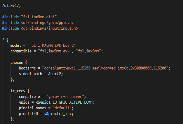

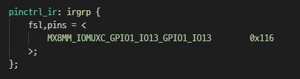

 1. I tried to modify the dts file as below
.../tmp/work-shared/imx8mmevk/kernel-source/arch/arm64/boot/dts/freescale/fsl-imx8mm-evk.dts
      &iomux {
         pinctrl-names = "default";
2. Kernel Compile..

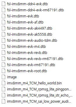

3. And Copy&Paste new dtb file in My SD-card
4. but, It doesn't apply.
