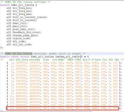

when i custom hdmi pixel clk ,i dont know how to set VCO configs.the Thirteenth table is my target(VCO_FRE=2929500),but how to config coar and cod(NDAC PMOS PTAT div-T P-Gain Coa V2I CAL)?
  pls help me. tks.

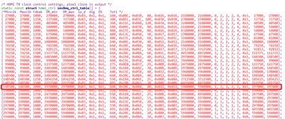

However, there is still a problem with this, and the output is unstable。I only see the output for a moment。
Are you  sure modify only this structure?My problem is the red marked structure in the screenshot。
2,595 Views
igorpadykov
yes only linux structure should be updated, no need to set pll values directly.

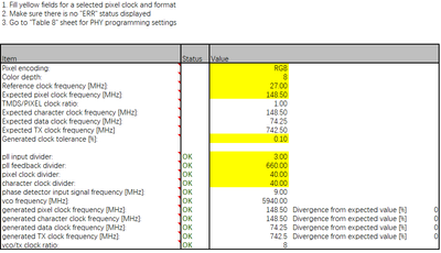

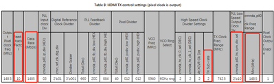

Kernel version I use is 5.4.3 and only this version can be used。i get structure's parameter by HDMI - pixel clock calculation.xlsx .but these different from the code,can you update the xlsx.
For example 148.5Mhz and vco 5940Mhz:
 code:
xlsx:

Do you mean that the PLL configuration must be one of these twelve?
