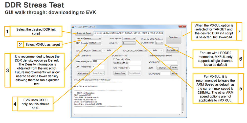

I did following steps >>

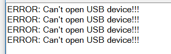

But when I click "Download" it shows >>
My board is imax6 quad sabre SDB and image running on SD card is " fsl-image-validation-imx-x11-imx6qdlsolo.sdcard" . As well as I connected the sabre SDB to host pc via USB OTG of sabre sdb and then device manager shows NOTHING in user interface. As well as the loaded init script is "MX6Q_SabreSD_DDR3_1GB_64bit.inc"
Please advice on this.
