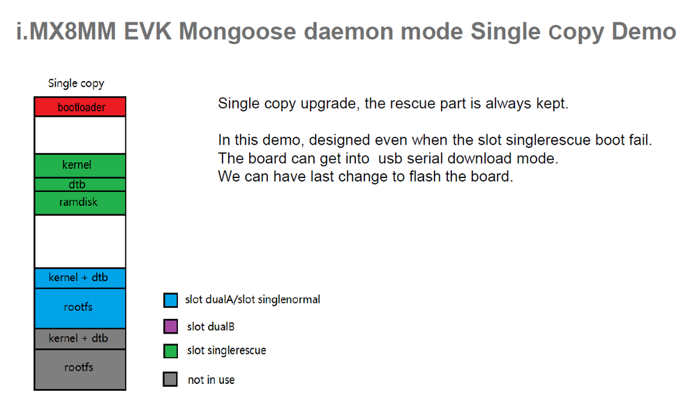

5,541件の閲覧回数
kimease
I notice you said "I do have the steps to use a regular rootfs booting on an SD card, but we need both environments".
Suggest you can read the page 35 of  SWUpdate OTA i.MX8MM EVK_rev3.pdf
SWUpdate OTA i.MX8MM EVK / i.MX8QXP MEK - NXP Community
Maybe that is what you want.
