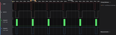

I have a simple program running on the M7 (i.MX8 Nano) which triggers a GPIO interrupt to unblock the SPI read when a "data ready" signal is received from the ADC  ~every 43us.
When I run this code in TCM, timing looks great and everything works beautifully.

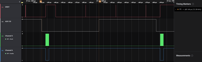

When I run the code from DDR, the ISR was not serviced timely and the entire routine to retrieve the SPI data takes about 10 times longer!  Is there a way to speed up the code running from the DDR?

[Q] Is there a way to speed up the code running from the DDR?
[A]
The biggest factor is cache! You must enable the M4 cache when running from DDR.
That will help you speed up the code running.
