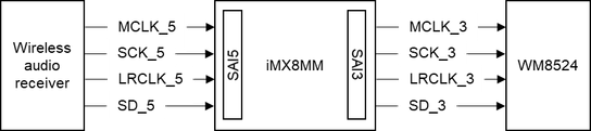

The objective is to synchronously render the audio signals received from a wireless IC (stereo in I2S format) through the WM8524 codec available on the iMX8MM EVK. Since the wireless IC relays the host audio timing, the SAI MCLKs on iMX8MM should be in sync with the MCLK coming from the wireless IC. The following depicts the system configuration and the two possible options for the MCLK routing. Based on the figures below, the goal is to use MCLK_5 as the MCLK for all the SAIs operating inside the iMX8MM.
1) Receive the external MCLK via SAIn_MCLK input pad
According to the iMX8MM reference manual, it is possible for both SAI5 and SAI3 to use the MCLK_5 as the master clock if MCLK_5 is fed to the SAI5_MCLK pad and the IOMUXC_GPR registers are configured accordingly. However, I don't see any document/examples about how to configure it correctly. I took a look at the Linux source files (e.g., fsl_sai.c, fsl_sai_sysfs.c), but it seems like such control is not implemented anywhere.

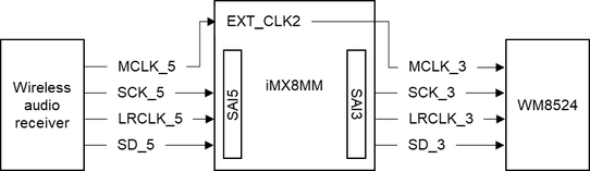

2) Receive the external MCLK via EXT_CLKn pin
Another possibility is to receive the MCLK_5 via EXT_CLK2 pin and distribute internally through the clock tree. But, the EXT_CLK2 pin is not readily accessible on the iMX8MM EVK. Also, it is less preferreable than the prior method of using the IOMUXC_GPR registers becuase we plan to involve additional SAI for our end appliaction. While the EXT_CLKn is shared between subset of SAIs, the IOMUXC_GPR-based method allows a complete flexibility in choosing the MCLK source.

For Q2:you should use
MX8MM_IOMUXC_SAI3_MCLK_SAI5_MCLK
, this config will let SAI3_MCLK select SAI5_MCLK as an input source.

Q1: According to RM, bit clock can be set as externally generated. Can you set it manually with memtool? The register address is 30050090 for SAI5 RCR2, Bit Clock Direction, you can see the explanation for MCLK Select.
Q2:MX8MM_IOMUXC_SAI3_MCLK_SAI5_MCLK mux sai3_mclk pad as sai5_mclk , the sai3_mclk is sai5_mclk.
