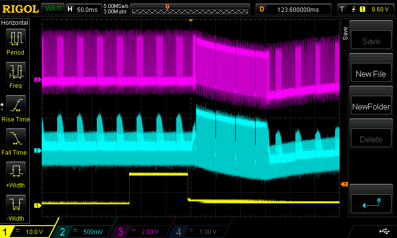

Below you can see oscilloscope output from our measurement, where we flashed bright light (white LED) directly into the camera, which causes bright flash of white on the LCD display (before the camera auto-gain even reacts), so there is rapid measurable change.
The channels show following:
  • Channel 1 (yellow) shows voltage on the LED (therefore shows when we flashed the LED).
  • Channel 2 shows Y component of YPrPb signal from camera. You can clearly see when the flash appears in the video signal, so we can measure the latency caused by the camera itself.
  • Channel 3 shows one differential pair in HDMI signal to LCD display. We were quite surprised that you can observe the change in HDMI signal so easily (even when using only 70 MHz oscilloscope). We can use this information to calculate the latency caused by processing in i.MX6. The cursors clearly shows that the latency is around 135 ms.
  • Channel 4 shows voltage on photodiode that was sensing the intensity of light from LCD panel, so it shows when the user can observe the change on LCD.

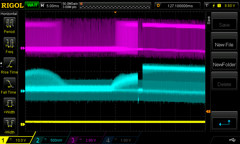

EDIT: I have measured delay caused by ADV7181C, results are attached.
Setup:
  • Channel 1: Voltage on LED, showing when the light is shining into the camera optics.
  • Channel 2: Y channel of YPbPr signal from camera, clearly showing that the signal is delayed by 3 frames.
  • Channel 3: CSI1-D9 input pin of i.MX6, which carries most significant bit of 16-bit parallel YPbPr signal from ADV7181C into the i.MX6.
Results:
Here you can clearly see when the signal from camera reacts to short pulse of light from LED. You can also see that the ADV7181C output is not significantly delayed.
Zoomed in little bit to show blanking between two frames (the short "gap" in the Y component from camera.
Zoomed in to show separate pulses in both signal and showing some change in signal so you can compare them.
Conclusion:
As you can see, there is no significant delay caused by ADV7181C. There is definitely delay caused by AD conversion, but we are talking about 74.275 MHz. That is pixel clock for 1080p30 (which is used by ADV7181C, although we use only 25p).
