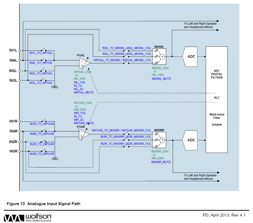

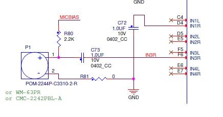

I typed alsamixer and a GUI appeared. I noticed "INPGAR IN3R" is disabled. How can I enable this pin?
The SABRE-SDB schematic shows microphone input as IN3R.
WM8962 Codec
