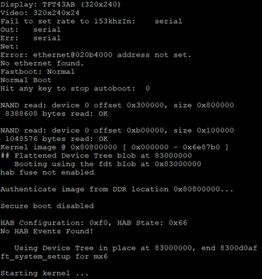

My detailed procedure on i.MX6UL based custom board is as follows.

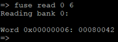

Check SEC_CONFIG[1] fuse in the open device.
Here is the U-Boot message for the open device.

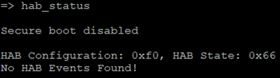

Verify HAB events.
The device successfully boots without generating any HAB events.
Check tamper status.

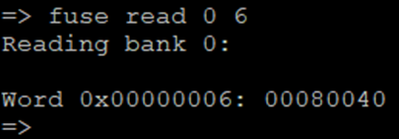

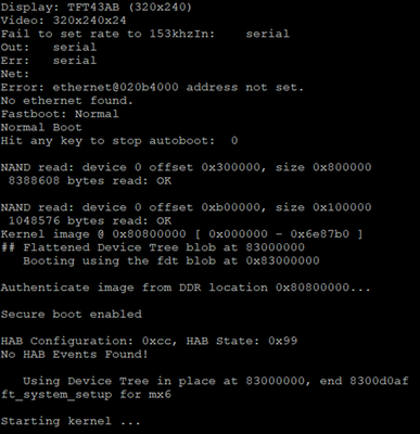

Check SEC_CONFIG[1] fuse after closing the device.
Here is the U-Boot message for the closed device.
The device can work in closed mode, but kernel has some error message as shown below.
