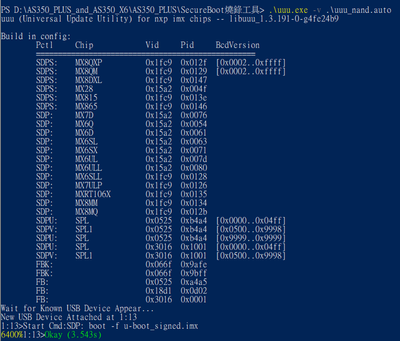

The burning procedure is locked in the following figure.
Is there any way to burn images to the device again after recovering tamper events?
I have attached my current U-Boot CSF file, zImage CSF file, and UUU script.
Please check the attachment to confirm if there are any wrong steps.
It's appreciated if you could give me some suggestions to resolve this issue.

TammyTsai
Hi @Harvey021 ,
UUU still fails to burn U-Boot image in closed device.
The closed device is unable to download an image in internal boot mode and serial downloader.
Does the closed device enable to burned images again when it has been tampered with?
Tammy

Harvey021
Hi @TammyTsai
Try reconfigure ZMK and unlock command in first csf.
Try parameter -d to burn image with uuu.
Harvey
