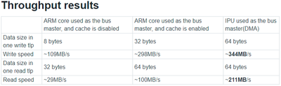

After our program did memory copy(copy from FPGA to IMX8MQ) by memcpy API, the rate was only 5MB/s.
I also use neon memcpy method to promote memory copy rate(about 11MB/s).
According to https://community.nxp.com/t5/i-MX-Processors-Knowledge-Base/i-MX6Q-PCIe-EP-RC-Validation-System/ta-p...,
all memory copy results are better than my test result.
And I find that memory copy of cached PCIe is better than uncached PCIe, and memory copy with IPU DMA is the best performance.
How to promote memory copy rate between FPGA and IMX8MQ?
Do I need change uncached PCIe to cached PCIe? If yes, how can I do?

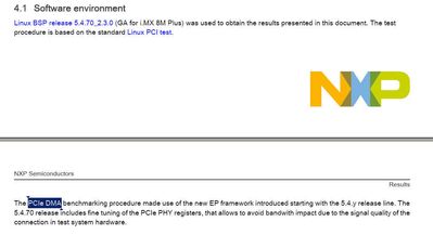

for PCIe performance analysis one can look at AN13164  iMX8MP PCIe Bandwith Analysis
https://www.kernel.org/doc/html/latest/PCI/endpoint/pci-test-howto.html

Is "Throughput results" section base on IMX8MQ(RC) side on URL https://community.nxp.com/t5/i-MX-Processors-Knowledge-Base/i-MX6Q-PCIe-EP-RC-Validation-System/ta-p...?

>Does IMX8MQ support DMA implemented on PCIe RC mode?
