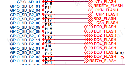

The FlexSPI pin connection to S26KS512 on my board is like the following picture shows.

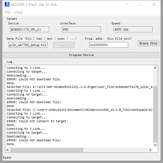

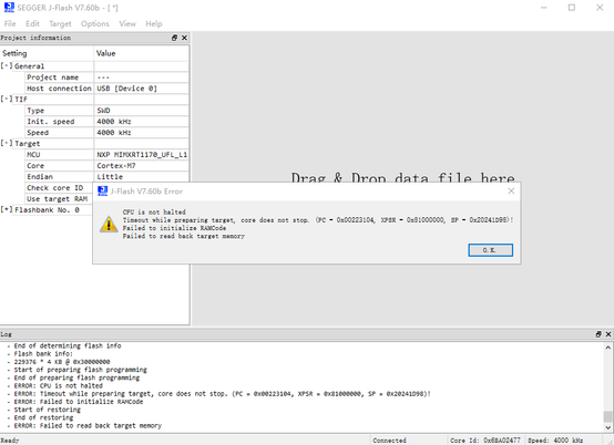

I followed your blogs to use UFL, just like the discription I mentioned before, I also tried Jlink download but failed, and when I tried to read back the flash, it also failed. The result is like the following.

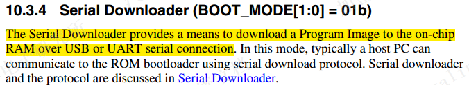

I have a question that whether setting boot mode to 2'b01 and programing flash with JLink is exact SDP mode, or setting boot mode to 2'b01 and programing flash with UART/USB is just exact SDP mode, as I notice this discription in "i.MX RT1170 Processor Reference Manual".
What's more, my board enter an error state that even ram can't be programed, and I guess it is because of some wrong flash programing tests. How can I make the board restore to the initial state that I can program the ram for debug at least before I can program the flash normally? It's important to point out that I don't have UART/USB to enter SDP mode, and I just have JLink now. So is there any software or hardware method to restore it?

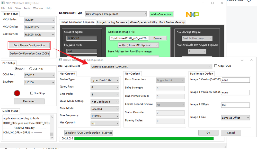

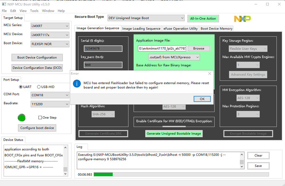

I have a test board with uart now and try to flash it with MCU Boot Utility, but it failed when click "configure boot device" as the picture shows.
configure boot device errorconfigure boot device error
The boot device configuration is like the following.
boot device configurationboot device configuration

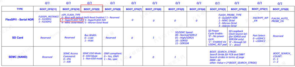

And I switch the BOOT_CFG[9] to ON according to the following discription in MIMXRT1170-EVK schematic.
boot_cfgboot_cfg
So is the boot_cfg right for hyperflash? Or is there any hardware signal to check?

Firstly, I was wondering if you can share the schematic of this board,
next, please use the
evkbimxrt1050_flexspi_hyper_flash_polling_transfer demo to try to access the Hyperflash,
lastly, can you upload the log of the MCU Boot Utility.
TIC
4,670 Views
yalin
@jeremyzhou
Thanks for support.
There is a hardware issue on my board, and I can program the hyperflash after fixing it.
