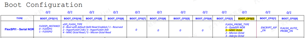

We use an octal flash CYPRESS S28HS512T with mimxrt1176, and it is not included in MCU Boot Utility, how can I program it with MCU Boot Utility?
I tried the Macronix_MX25UM51345G configuration but it blocked at "read-memory", the blhost log is attached as octal_block.log. Which configuration should I select?
configure boot deviceconfigure boot device
The flash schematic is like the following.
flash schematicflash schematic
And what is the right BOOT_CFG for CYPRESS S28HS512T as there are limited flash types not including CYPRESS S28HS512T?

We use an octal flash CYPRESS S28HS512T, I have tried all the demo configuration in MCU Boot Utility, but some failed, some blocked at "read-memory" like I mentioned above. Can you help check the right configuration in "boot device configuration" for octal flash CYPRESS S28HS512T?

Regarding the octal flash you want to program ( S28HS512T ), my teammate from China is still working on that one, and he will add S28H support in the below github link once he get samples from CYPRESS FAE.
https://github.com/JayHeng/RT-MFB
In the meantime, you could try to base on these examples for different tests from different flash memories, as Winbond/MXIC/GigaDevice/ISSI/Micron/Adesto, where you can find all tested parts in:
https://github.com/JayHeng/RT-MFB/blob/main/boards/mimxrt/mfb_fw/src/mfb_nor_flash.h
Now, it supports RT500/1010/1060/1170/1180.
Hope that helps, and please let me know if you need something additional.

Regarding your request, I will make sure to check it and then get back to you with a concrete answer. Also I would like to suggest using MCUXpresso Secure Provisioning Tool where there is an option to configure your memory to be used and then a Test button, before uploading an image to it. I will double-check it too.

Do you mean MCU Boot Utility can't program a flash not included in its "Boot Device Configuration" list?
3,880 Views
PabloAvalos
Hi @yalin
Thanks a lot for your patience.
I already have an answer from my teammate from China.
This is what he stands:
"The list in boot device configuration is just demo, it doesn't include all devices but it can support all the flash which is compatible with JESD216 standard"
So the answer for your question is, it can, you just will need to check if memory is compatible with that standard and the define the parameters for your memory on MCU Boot Utility.
Hope that helps, please let me know if you have more questions.
