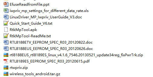

I have a imx6dl sabre-sd board with sdio I/F Wi-Fi (rtl8189es, connect to SD2).
How to port rtl8189es to Android JB4.2.2?
BTW, I got these from board maker.
