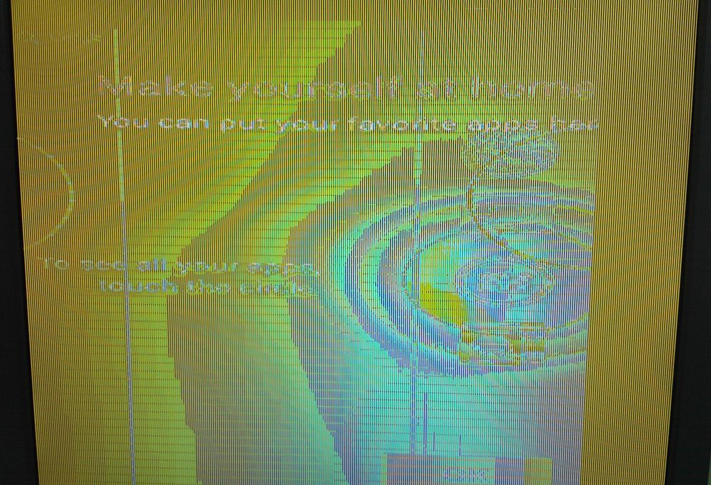

We have the same issue. We have a iMX6 sabre SD board. We downloaded the source code of jb4.2.2_1.1.0. We followed the guide and flashed the image to the board. We tried to set the resolution to be 1920x1080 and 1280x720 and they work fine. However, when we tried 1024x768, it results in the image like the following, do you have some suggestion on how to solve this?
The boot args we are using are:
setenv bootargs console=ttymxc0,115200 androidboot.console=ttymxc0 vmalloc=400M init=/init video=mxcfb0:dev=hdmi,1920x1080M@60,bpp=32 video=mxcfb1:off video=mxcfb2:off fbmem=28M androidboot.hardware=freescale
setenv bootargs console=ttymxc0,115200 androidboot.console=ttymxc0 vmalloc=400M init=/init video=mxcfb0:dev=hdmi,1280x720M@60,bpp=32 video=mxcfb1:off video=mxcfb2:off fbmem=28M androidboot.hardware=freescale
setenv bootargs console=ttymxc0,115200 androidboot.console=ttymxc0 vmalloc=400M init=/init video=mxcfb0:dev=hdmi,1024x768M@60,bpp=32 video=mxcfb1:off video=mxcfb2:off fbmem=28M androidboot.hardware=freescale
