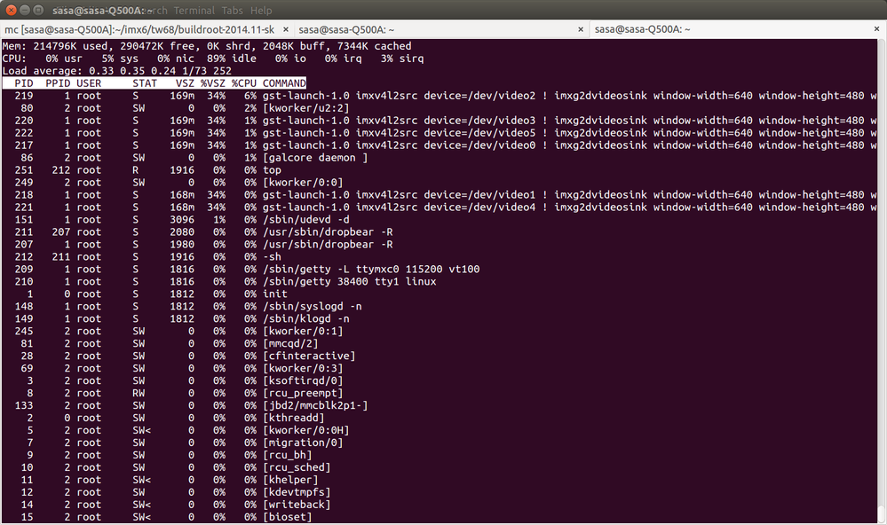

Hello, in attachment the new version of the driver:
1 for gstreamer-imx plugins (master branch) patch/hack isn't required any more
https://github.com/Freescale/gstreamer-imx

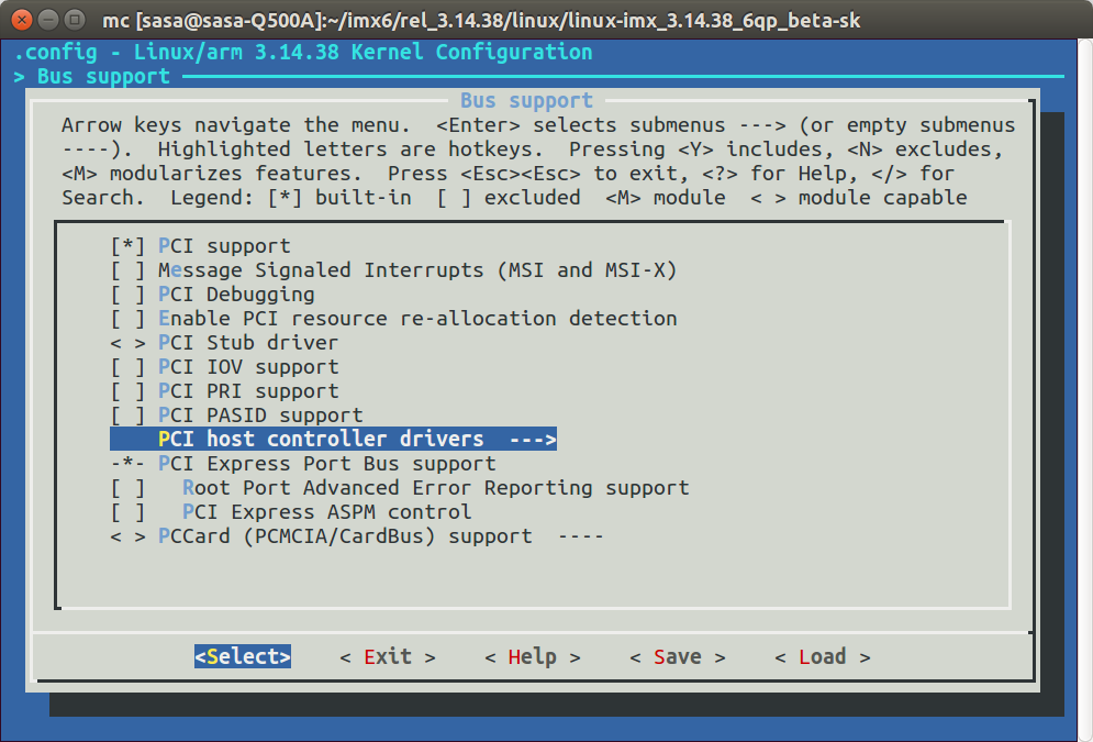

2 MSI support should be disabled in the kernel config
