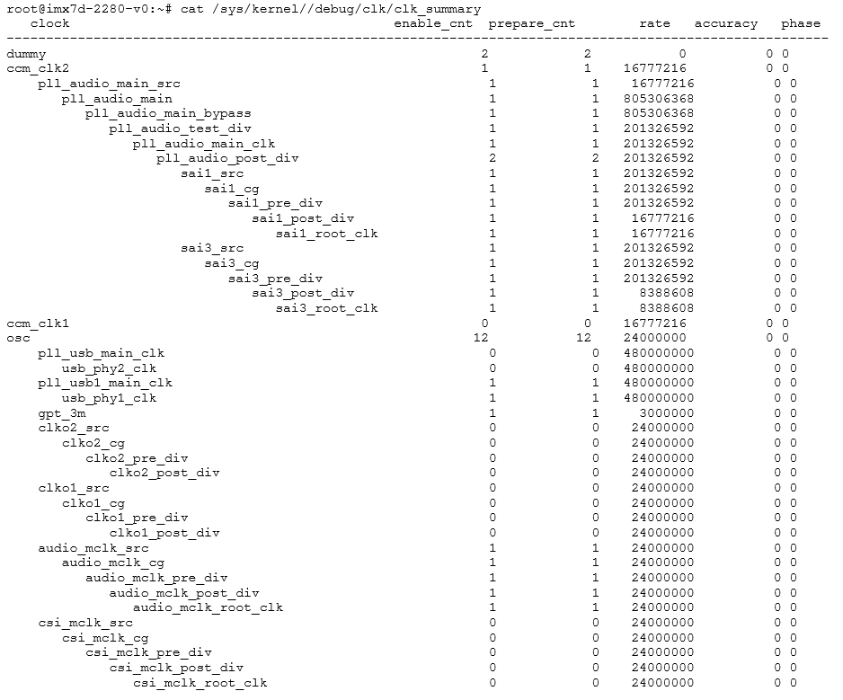

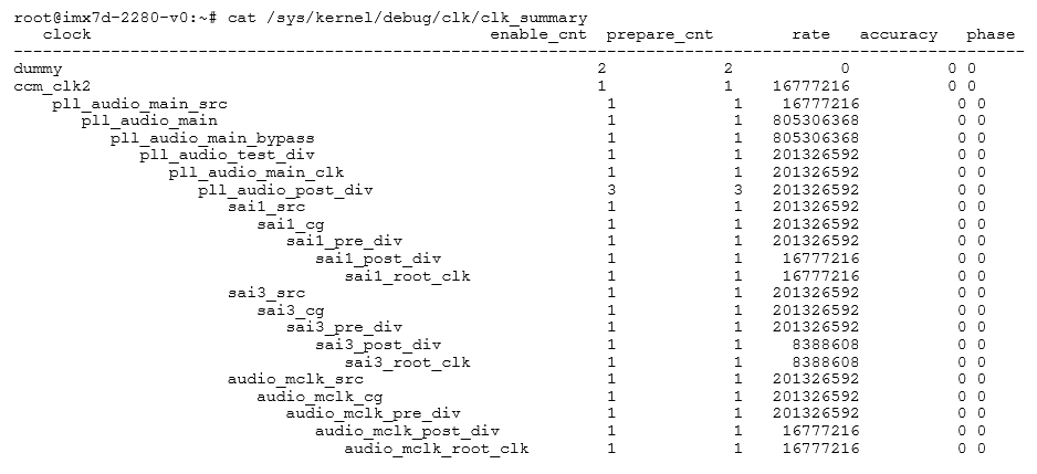

thomaskofoedhan
Hi Igor,
thank you for your quick answer. I'm just not sure I understand it correctly.
Below you can see some of our clock tree made with a clk_summary tool.
In your answer you say that SAI MCLK always comes from SAIx_CLK_ROOT and as you can see we have 2 of these.
SAI1_CLK_ROOT      16.777216MHz
SAI3_CLK_ROOT      8.388608MHz
We have had no luck gating these clocks out on the MCLK pins. But we also have an AUDIO_MCLK_ROOT_CLK, and it is this clock that we see on both MCLK outputs. We have tried changing the AUDIO_MCLK_ROOT_CLK frequency and can see the changes on both MCLK outputs.
If what you say about "SAI MCLK always comes from the SAIx_CLK_ROOT" is true, then it seems we can generate 2 different clocks but how do we route these to the pins?
And why do we see the AUDIO_MCLK_ROOT_CLK on the pins?

thomaskofoedhan
We determined that it was AUDIO_MCLK_CLK by having setup the different clock as shown below
AUDIO_MCLK_CLK - 4MHz
SAI1_CLK_ROOT - 16MHz
SAI3_CLK_ROOT - 8MHz
and then measure the frequency on both MCLK pins (SAI1 and SAI3). We measured 4MHz on both, with all tested settings.
We have now tried setting CCM_CCGR140 to 0x0 10ms after previous settings where enabled, and this stopped the bit clock but did not change the MCLK frequency which is still equal to AUDIO_MCLK_CLK.
Thomas

thomaskofoedhan
Hi Igor,
we have tried what you suggested and it changes the MCLK pin signals to 24MHz. Below you can see the modified clock tree.
