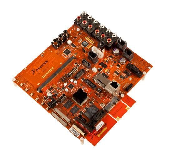

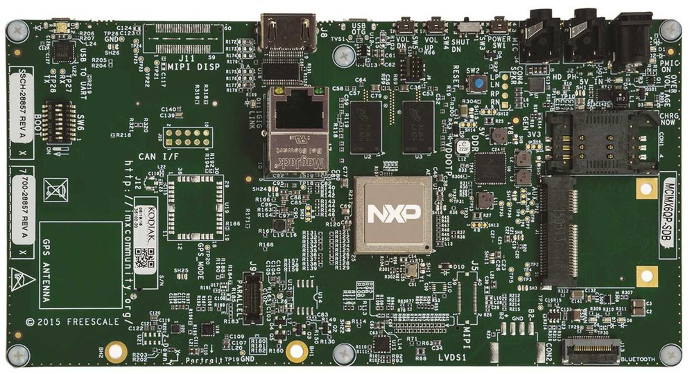

toshihiro_kambe
Dear igorpadykov-san
My using Sabre board is old type, dose it not matter?
< current imx6 Sabre board in NXP>
<My using Sabre board>
6,896 Views
igorpadykov
Hi 俊大 神戸
these are two different boards:
first: i.MX6QP Sabre-SD, I see marking sch-28857  rev.A   MCIMX6QP-SDB
second, orange below is Sabre AI, SCH-27142 REV B1
Note these are completely two different boards with different processors:
i.MX6QP and i.MX6Q. So no need to compare them.
Also different images should be used for them.
igor

toshihiro_kambe
Thank you for your response.
I'm understood. Sabre-SD and Sabre AI are another type.
I using the old(2012) board of Sabre AI.
