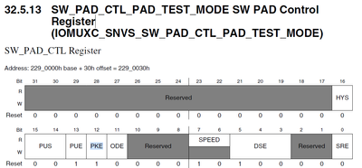

I'd also like to know the procedure to set the all the GPIOs available on the IMX.6UL to a default low state.
The Application running on the processor has variable loads connected to the GPIOs via relays, The Power supplied to those loads aren't sufficient if all the loads get turned on while we are booting up the processor. Hence, we need the GPIOs to be in LOW state while we boot the device. Please suggest a way to do the same.
Information on how to calculate these values '0xf0a1 / 0x70a1' would be highly appreciated.

See your iMX7ULL Reference Manual
https://www.nxp.com/webapp/Download?colCode=IMX6ULLRM
Look for specific PAD Control Register. Most of these pad control register have the same fields, but there are as well some differences. For example
