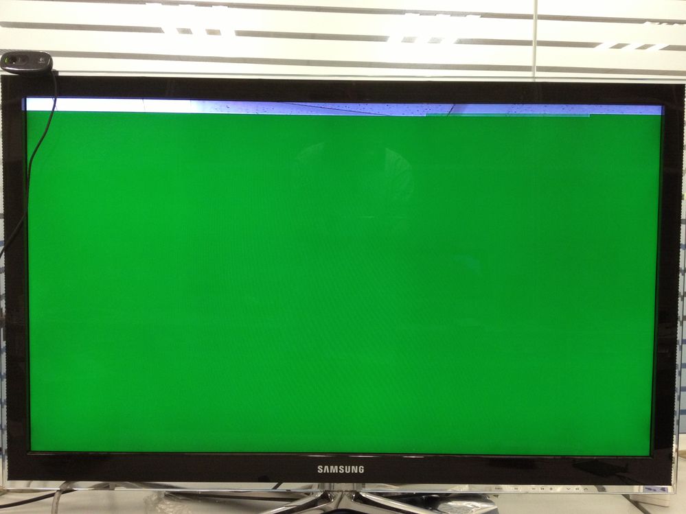

huangjacky
Thanks for your reply!
I have try the vpudec before!  but....
I got the green screen!
and the vpudec output the error print as below:
New clock: GstSystemClock
[INFO]  bitstreamMode 1, chromaInterleave 0, mapType 0, tiled2LinearEnable 0
[ERR]   JpegDecodeHeader failure
>>V4L_SINK: Actually buffer status:
        hardware buffer : 7
        software buffer : 0
full screen size:1280x720
