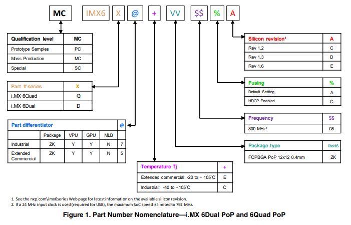

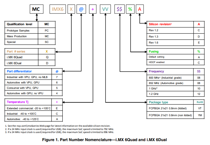

For example, for MCIMX6D7CZK08AD, I know it is i.MX 6 family. But how to know which category it belongs, 6QuadPlus, 6Quad, 6DualLite, 6Dual or anything else?

You can check more about this on the datasheet for the i.MX 6 Dual/Quad processors
And for the i.MX 6 Dual/Quad PoP
Hope this helps,
Aldo.
