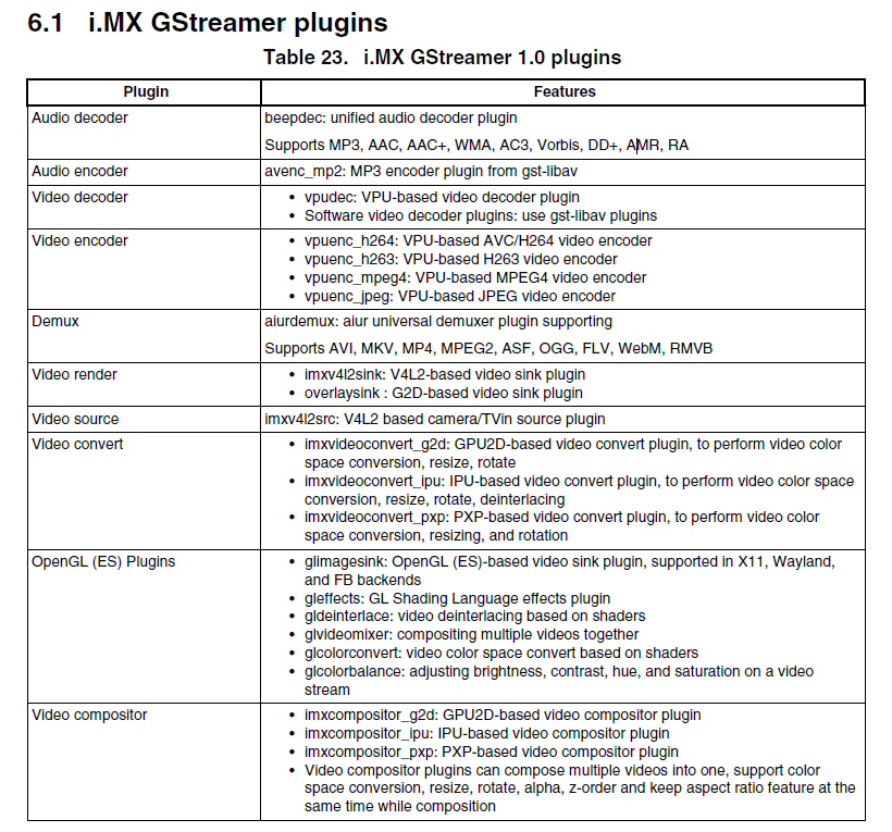

I am working on IMX6 based platform and using gst-fsl-plugins for audio encoding and decoding. How to know the list of elements supported by the gst-fsl-plugin. example : mfw_mp3encoder is used for mp3 encoding .
Where can I get the complete list of elements supported by gst-fsl-plugin.

Hi Aditya,
Please check the section 6.1 of the BSP release notes documentation, in order to know the elements supported by gstreamer plugins in NXP release.
