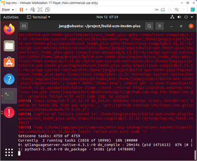

JROM
 As shown in the attached picture, an error occurred during bitbake build and the process is stopped.
What should I do?

Dhruvit
Hi @JROM,
I hope you are doing well.
This issue is occurring while fetching linux-imx from github.
Please make sure that the firewall is not blocking that site.
Thanks & Regards,
