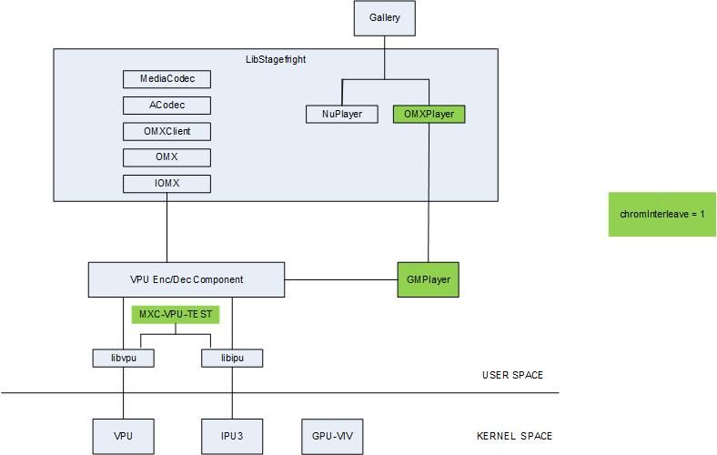

gurtajs4
I am using MediaCodec API with BSP Android L5.1.1_2.1.0 GA.
We know that the OMXPlayer uses the fsl_imx_omx. Again the striped version of "fsl_imx_omx" is "fsl_vpu_omx".
So in Android, Freescale uses fsl_vpu_omx to interface hardware codec with libstagefright.
Speaking of which, MediaCodec uses fsl_vpu_omx for decoding.
If that correct then what about the Rendering in MediaCodec ??
Does it uses fsl_vpu_omx  as a renderer?? or Is it differently linked with SurefaceFlinger.?
See, the Green Path works with no issue, but the Mediacodec path are having issue with decoding + rendering the frame at 16.6 fps for 1080p60fps video.
I wanted to isolate the issue. Either its in decoder or renderer.
Can you suggest some way here?
Gurtaj

yifangguo-b4310
Hi Gurtaj Singh,
  I agree with you,  should distinguish the OpenMax VPU component issue or  surface render display issue.
you said "the Green Path works with no issue" , is that mean  if  only use VPU component(no surface render handlle), the vpu decode  speed can reached 60fps ?  if yes,  the issue happend on rendering mechanism.
In "fsl_imx_omx" package, OMX_player use OpenMAX component "OMX.Freescale.std.video_render.surface.sw-based" as render component.
In "fsl_vpu_omx" package, stagefright  use Android libstagefright default render method "AwesomeRenderer".
9,216 Views
gurtajs4
Hi Yifang Guo,yifangguo-b43107
Yes, if only VPU Component is used (no surface render handlle), the vpu decode  speed can reached upto 65-75fps. This is with 1080p video 25MB bitrate and 60 FPS. But since we are using Android libstagefright default render, the overall output fps achieve ( both including decoding and rendering ) is less than 60. It is around 50 FPS

gurtajs4
Ok I see the point.
I don't have  fsl_imx_omx, we only have fsl_vpu_omx
The problem is I am using MediaCodec API and MediaCodec uses VPU for decoding and Android libstagefright default render method.
Decoding is fine, Rendering is slow and hence the overall video playback with MediaCodec is slow ( 1 Minute video takes 1.5 minutes to complete).
I still want to use MedaiCodec API's . There is no other option to decode h264 elementary stream in JAVA.
How can I speed up the rendering.
