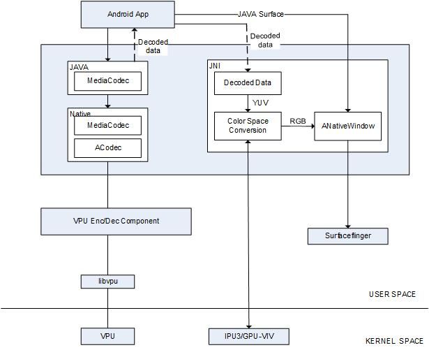

Sir, If I apply fsl_imx_omx patches, then the changes effect only mediaplayerservice and the Gallery will by default start using OMXPlayer instead of Awesome/NuPlayer.
But as you can see in the picture above, we wanted to use MediaCodec API to decode raw h264.
And at no point from the above diagram I see MediaCodec using Freescale renderer, it always uses Awesome renderer and which could be the issue.
Is my understanding correct???

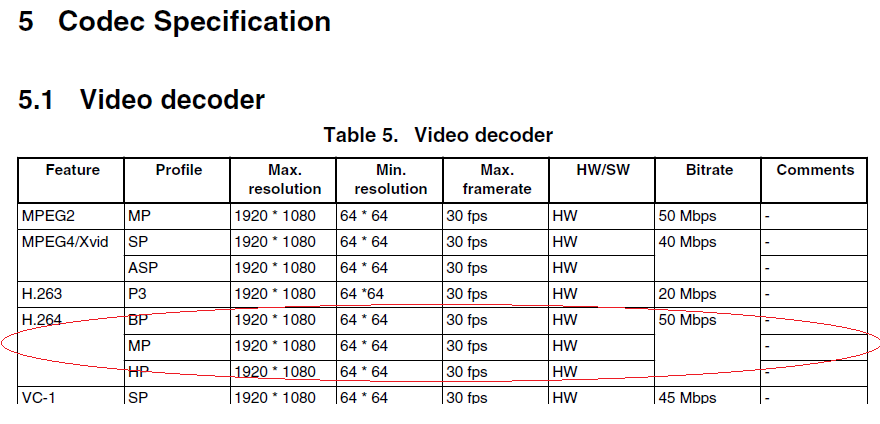

As "i.MX_Android_Extended_Codec_Release_Notes.pdf" spec,
Android  Codec spec of H.264 1080p decoder  can only guarantee the MAX framerate 30fps . Don't guarantee more than 30fps  in Android System expect  an baremetal(no os) demo.

"Android  Codec spec of H.264 1080p decoder  can only guarantee the MAX framerate 30fps . Don't guarantee more than 30fps  in Android System expect  an baremetal(no os) demo."
[Gurtaj] I know that the spec says no guarantee for more than 30FPS, Can you answer the below questions

Yes, We wanted to use MediaCodec to only Decode (just only use  VPU component decode and no rendering). Later save the decoded YUV frames to a file.
As you can see from the starting of the thread, I am asking for help to do this approach
Can you help me with best way and some test code to do
1. The YUV to RGB color conversion.
2. Render the converted image to framebuffer ( Zero Copy Approach ??).
If, i have a test code to perform the two methods in the minimum time, let say 2-3 millisecond. Then we will be able to narrow down and isolate the issue.
Gurtaj

    The approach  of YUV  data  rendered  to NativeWindow  is a standard way in Android.  But in your test,  the render method can't reached to 60fps.
As your diagram,  If you want to high performace of render,  suggest the decoded YUV data is transferred to NativeWindow API directly  in Android Frameworks(Native development ), don't export YUV data to  Jave  space, that is  inefficient.
