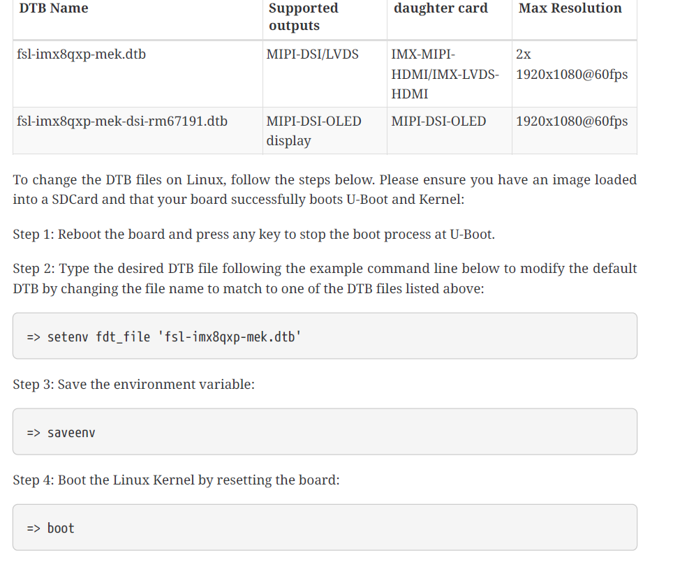

These DTS files affect the behavior of the displays connected to the mini-SAS connectors, which expand your
multimedia experience in combination with the range of daughter cards available for the i.MX8QXP MEK.
How to set you can see
https://www.nxp.com/webapp/Download?colCode=AN12189
https://www.nxp.com/webapp/Download?colCode=AN12188
https://www.nxp.com/webapp/Download?colCode=AN12187
You can refer to these documents.
