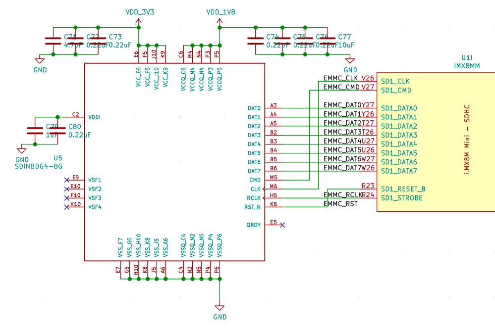

We are unable to get fast boot mode with ack working on eMMC when configured for 8-bit hs DDR mode on our custom board. The eMMC hardware works correctly both after loading u-boot through sdp and when booting into Linux from there, but the boot ROM will not load u-boot from the eMMC, it will always fall back to serial download. It doesn't appear to fall back to normal boot mode either.
Our eMMC does support HS ddr @ 52MHz 1.8V. It is a v5.1 card, and should support everything needed for boot:
Boot Information [BOOT_INFO: 0x07]
Device supports alternative boot method
Device supports dual data rate during boot
Device supports high speed timing during boot
mmc extcsd has been set up, trying both through u-boot and through linux.

Here is how we have the eMMC wired:
I'm not sure what else to try or check! By all accounts, it seems like boot from eMMC should work. Please help.

Please check your spl.c under the board directory.  It must setup usdhc1 in board_mmc_init, since our imx8mm_evk does not use usdhc1, it only setups usdhc2 and usdhc3, you may refer to the imx8mq_evk, in this board it uses usdhc1 for emmc as in your design.
Also, you'll need to change board_mmc_get_env_dev" API according to board specific, like the following

Thanks for the reply, Aldo. Yes, I am already doing this. Also, I've fixed up spl_boot_device() to return BOOT_DEVICE_MMC1 for SD1_BOOT. The SPL works properly when I load it from the serial downloader, and eMMC works from u-boot as expected.
Note that it's not getting this far -- I don't get any output from my SPL at all so it seems that it's never running. After about 15 seconds from POR, the usb device from the ROM serial downloader shows up instead.
