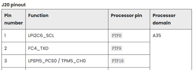

PTF19 (J20 pin3)

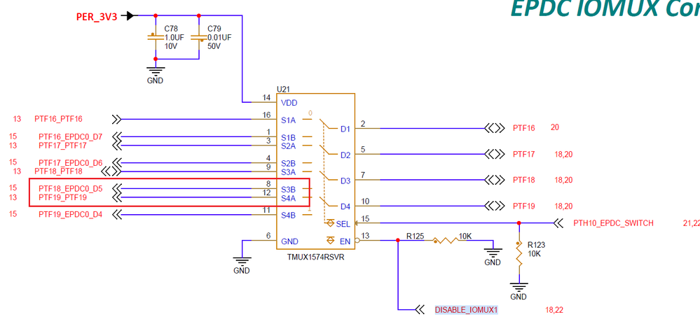

Zhiming_Liu
The signal from PTF19 is muxed to EPDC_D4 or PTF19_PTF19
Try to include below line in tpm5 node.
pinctrl-assert-gpios = <&pca6416_1 10 GPIO_ACTIVE_LOW>;
Zhiming

wendy-liu
Thanks for your helping!But it still doesn't work(T_T)
