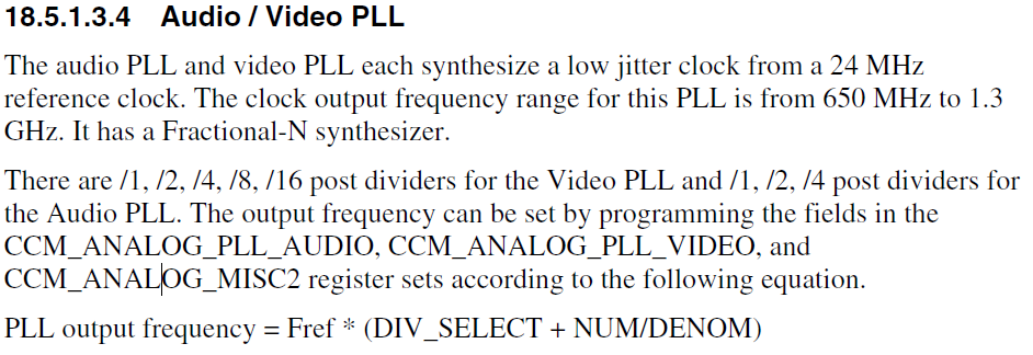

I want to generate 24.576Mhz to CLKO1.
I tried  the CCM configration with Audio PLL register (CCM_ANALOG_PLL_AUDIO / CCM_ANALOG_PLL_AUDIO_NUM / CCM_ANALOG_PLL_AUDIO_DENOM).
Plase let me konw how to generate 24.576MHz(CLKO1) from 24MHz(OSC) and if possible, provide reference code(clk-imx6q.c).

one can try to configure PLL for 737.28MHz (24.576=737.28/30) with
DIV=30, NUM=72, DENOM=100 and dividing with ssi_clk_pred, with ssi_clk_podf,
output ssi_clk_root on CLKO.
igor

jackeyko
Hi Igor,
I have succeed to generate 24.576Mhz to CLK1 with your configuration.
Thank you so much.

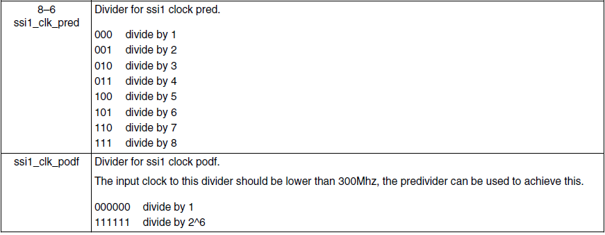

Hi Igor,
Thanks for your message.
I understood your PLL configration(DIV=30, NUM=72, DENOM=100).
But How to configure 30 devider(24.576=737.28/30) with ssi_clk_pred and ssi_clk_podf?
[ssi1_clk_pred and ssi1_clk_podf register - 20C_4028h]
Please let me konw ssi clk pred and ssi clk podf configration.
Jackey

Hi Jackey
for 30 divider one can select
ssi_clk_pred=100  (divide by 5)
ssi_clk_podf=101  (divide by 6)
igor
