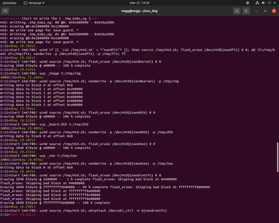

We created a custom i.MX6UL board. We successfully able to load SDCard Yocto image to the board. Now we want to load Nand image to our custom board of i.MX6UL as we are using NAND FLash in our board. But the kernel is not able to find the UBI partition in the system and the boot stops there.Part number for our NAND Flash is 'MT29F32G08CBADBWP-12IT:D TR'. We are using following scrpit to load image to NAND Flash with UUU version 'uuu_version 1.2.39'
https://github.com/NXPmicro/mfgtools/wiki/Sample-script#burn-nand-flash-by-linux-kernel
We also tired load image using the mfg-tools version L4.1.15_2.0.0-ga_mfg-tools. But it stuck at
'Starting UTP' . Below i attached the log for both UUU flash and Mfg-tool. I also attched the printenv log when flashed through UUU.
The files I used is as follows:
1) uboot-dtb.imx → _flash_fw.bin & _flash.bin
2) uTee-6ulevk → _tee
3) fsl-image-mfgtool-initramfs-imx_mfgtools.cpio.gz.u-boot (from L4.14.98 official demo) → _initramfs.cpio.gz.uboot
4) imx6ul-14x14-evk-gpmi-weim.dtb → _board.dtb
5) fsl-image-machine-test.rootfs.tar.bz2 → _rootfs.tar.bz2
6) zImage→ _Image
As support for i.MX6UL NAND UBOOT_CONFIG is not available in YOCTO-3.3 (Hardknott). So we created generated the U-Boot and kernel Image as guided in IMX_LINUX_USERS_GUIDE at page no.37. The U-boot and kernel version we are using to generate images are 'lf_v2021.04' and 'lf-5.10.y' respectively.
We also followed the below NXP guide to burn image to NAND FLASH but it stops after u-boot.
https://community.nxp.com/t5/i-MX-Processors-Knowledge-Base/How-To-use-NAND-boot-on-i-MX6UL-EVK-boar...
UUU stops after erasing Nand Flash for writing rootfs in it.Any help will be appreciated.Screenshot from 2022-03-22 14-59-15.png

harit
Thank you, for your reply.
We already tried the built-in command available in UUU as you have shown. But as it is only for flashing u-boot we are able to load u-boot in our Nand Flash. And when we try to add _image parameter as our zImage file we get an error of 'unknown command nandbcb' on the serial terminal. I also exactly don't know what file we have to give in _image parameter, can you please also tell which file we have to give in _image parameter? And yes the script of 'example_kernel_nand.uuu' is the same one I get from the github repo of NXPmicro/mfgtools.
I hope you can see the attached log file of flashing from UUU. We are able to write U-boot, DTB, uTee and FIT in our Nand Flash but it fails at writing rootfs shows the error of 'UBI partition not available'. We have used the rootfs file generated by Yocto when I make yocto image for SDCard. Will this rootfs file will work for Nand Flash?

harit
We tired to run all the commands present in uuu script file line by line writing them in shell mode of uuu. But it still fails at same command "FBK: ucmd source /tmp/mtd.sh; ubiattach /dev/ubi_ctrl -m ${nandrootfs}" present in script while burning rootfs to Nand Flash.
We tired the command:
FBK: ucmd ls /dev/mtd*
This gives list of available device  as follow:
U>FBK: ucmd ls /dev/mtd*
1:14>Start Cmd:FBK: ucmd ls /dev/mtd*
New USB Device Attached at 1:14
/dev/mtd0
/dev/mtd0ro
/dev/mtd1
/dev/mtd1ro
/dev/mtd2
/dev/mtd2ro
/dev/mtd3
/dev/mtd3ro
/dev/mtd4
/dev/mtd4ro
/dev/mtdblock0
/dev/mtdblock1
/dev/mtdblock2
/dev/mtdblock3
/dev/mtdblock4
1:14>Okay (0.165s)
Okay

harit
It seems that it’s not finding a UBIATTACH,
When we are trying to run with uuu and ubi.We have tried finding any files related to kernel and ubiattach but the kernel(lf-5.10.y) that we are using doesn’t seems to have that.May be we are using a kernel that doesn’t support ubiattach. but we don’t know where to find a right one.Here is the log that we have when it fails.
run shell cmd: source /tmp/mtd.sh; flash_erase /dev/mtd${nandrootfs} 0 0
[   33.914966] random: crng init done
run shell cmd: source /tmp/mtd.sh; ubiattach /dev/ubi_ctrl -m ${nandrootfs}
ubiattach: error!: UBI is not present in the system
10,140 次查看
BiyongSUN
open the
found ubiattach is in /usr/sbin/
tree --charset . /usr/sbin/
