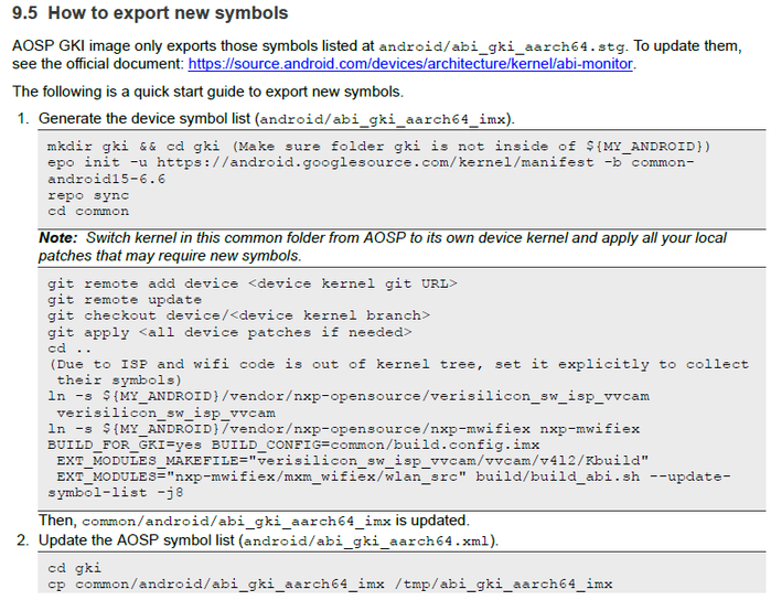

Hi NXP
how to export new kernel symbols on android-14.0.0_2.2.0. I refer to this https://community.nxp.com/t5/i-MX-Processors-Knowledge-Base/Export-new-symbols-of-GKI-development-An...
But it does not work on android-14.0.0_2.2.0 BSP.
Please help me, How should I do ?

liangyan
mkdir gki && cd gki (Make sure folder gki is not inside of ${MY_ANDROID})
epo init -u https://android.googlesource.com/kernel/manifest -b commonandroid15-6.6
repo sync
cd common
git remote add device <device kernel git URL> (I do not know how to do it)
git remote update (I do not know how to do it)
git checkout device/<device kernel branch> (I do not know how to do it)
git apply <all device patches if needed> (I do not know how to do it)
cd ..
ln -s ${MY_ANDROID}/vendor/nxp-opensource/verisilicon_sw_isp_vvcam
ln -s ${MY_ANDROID}/vendor/nxp-opensource/nxp-mwifiex nxp-mwifiex
BUILD_FOR_GKI=yes BUILD_CONFIG=common/build.config.imx
EXT_MODULES_MAKEFILE="verisilicon_sw_isp_vvcam/vvcam/v4l2/Kbuild"
EXT_MODULES="nxp-mwifiex/mxm_wifiex/wlan_src" build/build_abi.sh --updatesymbol-list -j8 (build_abi.sh it not found);

Hi @liangyan
Please refer to the update android user guide.
Android User's Guide
The <device kernel git URL> is url of linux-imx.
you can try below commands:
git remote add device http://github.com/nxp-imx/linux-imx
git remote update

I show my steps:
step1: export MY_ANDROID=../IMX8MP_Android14/(aosp source code dir)
step2:
mkdir gki && cd gki
step3:
repo init -u https://android.googlesource.com/kernel/manifest -b common-android15-6.6
step4:
repo sync
step5: cd common
step6: git remote add device <device kernel git URL>  (I do not know how to do)
step7:git remote update ((I do not know how to do))
step8: git checkout device/<device kernel branch> (I do not know how to do)
step9:git apply <all device patches if needed>(I do not know how to do)
step10:cd ..
step11: ln -s ${MY_ANDROID}/vendor/nxp-opensource/verisilicon_sw_isp_vvcam
steop12:ln -s ${MY_ANDROID}/vendor/nxp-opensource/nxp-mwifiex nxp-mwifiex
step13: BUILD_FOR_GKI=yes BUILD_CONFIG=common/build.config.imx
step14:EXT_MODULES_MAKEFILE="verisilicon_sw_isp_vvcam/vvcam/v4l2/Kbuild"
step15:EXT_MODULES="nxp-mwifiex/mxm_wifiex/wlan_src"
step16:
       bash: build/build_abi.sh: not found build_abi.sh file

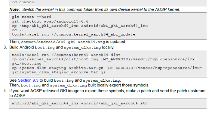

danielchen
I would suggest you refer to UG10156:  Android user's guider. Rev. android-14.0.0_2.2.0
chapter 9.5
Please refer to UG10156 for more details
https://www.nxp.com.cn/docs/en/user-guide/ANDROID_USERS_GUIDE.pdf

liangyan
yes, I read this papes mush times, but, I can not know how to do this step by step.
can you show me the  steps in IMX8MP platform?
