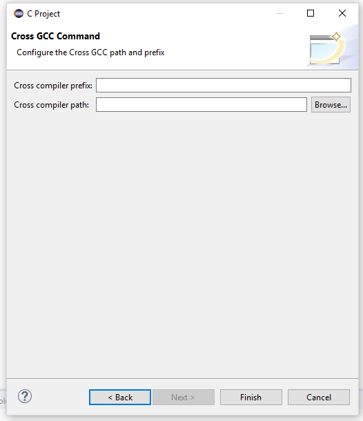

guo_li
MEK is Multisensory Enablement Kit, the board running Linux. I originally thought the MEK linux comes with gcc but later I found no gcc was installed. So your solution is correct, use cross compiler as your described.
I also noticed that the default linux coming with MEK doesn't have sftp installed :smileysad:, so PSFTP cannot be used too. Need other solutions.

anaseem
>>  use cross compiler
What do I enter in below fields?
