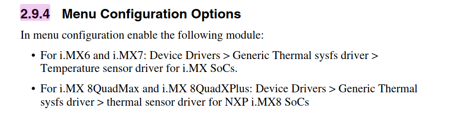

igorpadykov
Hi Javer
one can try settings described in sect.2.9.4 Menu Configuration Options
i.MX Linux Reference Manual
igor

javerv
Hello Igor,
Good day!
Yes, I already implemented that as I have explained above.
I'm thinking if there is any pin that can affect this?
Or is there any modification in device-tree I need to implement?
Javer
