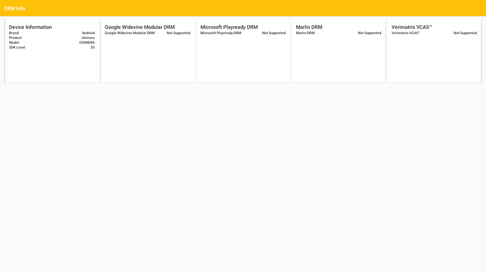

SOC: i.mx8mq
Code: android-13.0.0_2.0.0
1. we have another code base of android 11, it support Widevine.
there is a vendor/widevine folder in android 11.
2. android 13 show not support.
there is no vendor/widevine folder in android 13.
so, How to enable Widevine DRM level 3 on android 13?
Attach pictures are checked by "DRM Info" app.
Widevine supported in android 11
Widevine supported in android 11Widevine supported in android 11
Widevine not supported in android 13
Widevine not supported in android 13Widevine not supported in android 13

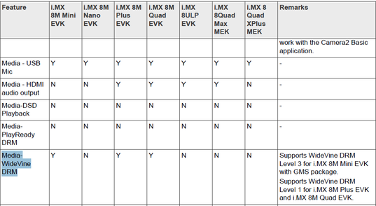

I confirmed this from android team, if you need request the package, pls follow
1) get google widevine license
2) sign NDA with NXP, then we will give you flexera code
then you can download widevine package from nxp.com

One more question,  could nxp release vendor/widevine folder in android 13 ?
1.  no ,  vendor/widevine no longer available in android 13.
2. yes, contact local FAE for vendor/widevine .

2,097 Views
joanxie
refer to the android 13 release note, Supports WideVine DRM
Level 1 for i.MX 8M Plus EVK and i.MX 8M Quad EVK.
for more detailed information, you also can refer to the chapter 3.3.8 Provisioning Widevine L1 keybox of android security user guide
