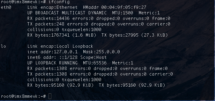

Hi Folks,
We are testing an i.MX 8M Mini EVK which is running the Linux image (L4.14.78_1.0.0_ga_images_MX8MMEVK). The question is how to enable the WIFI? With the linux terminal, we only see eth0 and lo. Much appreciate any advice. Thank you. Screen Shot 2019-03-14 at 3.14.35 PM.png

It worked for me with below sequence,
Connect to wifi antenna in SOM. after that follow below step to enable wifi on full image,
wifi setup on the board i.MX8MN,
#ifconfig wlan0 up
#vi /etc/wpa_supplicant.conf
add wifi ssid and password as below,
network={
scan_ssid=1
ssid="Wifi_ssid_NAME"
psk="password"
#wpa_supplicant -B -i wlan0 -c /etc/wpa_supplicant.conf -D nl80211
#ifconfig wlan0
#udhcpc -i wlan0
#ping 8.8.8.8
After that I could see response from 8.8.8.8 (google).

Mini tutorial on how I got my board's WiFi up. Took me a while so might be helpful to someone.
Board:   MCIMX8M-EVK
Linux:     L4.14.98_2.0.0 (should work with 4.78)
Use iwconfig instead of ifconfig to bring interface up:
   ifconfig wlan0 up
Check if it works by scanning for SSIDs:
   iwlist wlan0 scan
Use editor to edit /etc/wpa_supplicant.conf :
   mcedit /etc/wpa_supplicant.conf
Change the Network block to as follows (keep the quotation marks):
   Network={
      scan_ssid=1
      ssid="YOUR_SSID_NAME"
      psk="YOUR_PASSWORD"
Associate the wlan with config:
Check if you have right SSID associated now:
   iwconfig wlan0
Rung DHCP client from BusyBox to get the IP (yup, there is no dhclient):
   udhcpc -i wlan0
Check the network:
   ping www.google.com

one can try procedures described in sect.4.13 Wi-Fi attached Linux Manual.
igor
