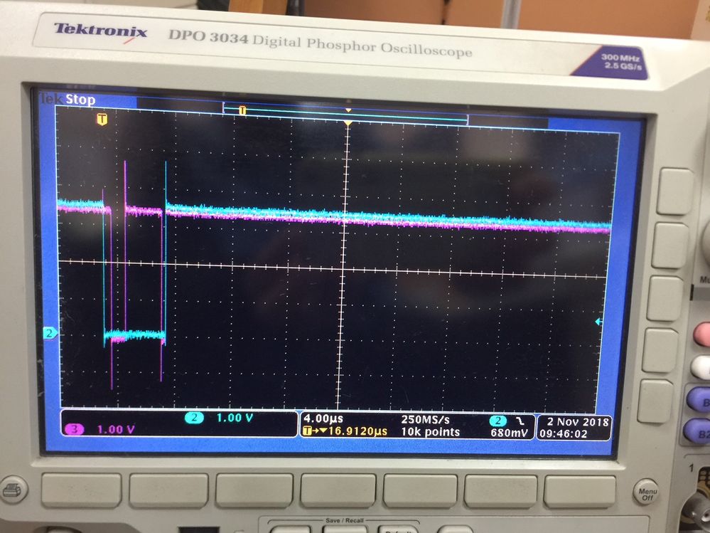

Hi all,
We would like to enable SPI2 on i.mx6ull, but we have no idea how to modify the device tree. Would you please advise us how to enable it and check it  ? Thanks.
We have already added this piece of description in arch\arm\boot\dts\imx6ull-14x14-evk.dts.
&ecspi2 {
fsl,spi-num-chipselects = <1>;
cs-gpios = <&gpio4 22 0>;
pinctrl-names = "default";
pinctrl-0 = <&pinctrl_ecspi2_1 &pinctrl_ecspi2_cs_1>;
status = "disabled";

stevenyu
Hi Igor,
Thanks for your comments, and we have modified it to okay now. However, the chip select does not wait for SPI nor flash to return feedback data and just close and stop(as in attach picture), and we think cs-gpio=<0> setting maybe the reason. We have seen the example you show us, and it is cs-gpio=<&gpio ooxx>. But MX6UL_PAD_UART4_RX_DATA__ECSPI2_SS0 is not gpio, how should we configure cs-gpio here ?

Hi Steven
for enabling native chip select one can refer to
How to enable native and gpio cs on ecspi
However I do not think that it will help for problem that "chip select does not wait for SPI",
seems you should just decrease ecspi frequency.
