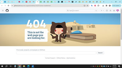

https://github.com/nxp-imx-support/imx8mp-imx219-sensor-enablement
this link not able to open can you please check and also if we will use serial camera interface SCCB communication then the same things will be working same driver ?

joanxie
because of license issue, this software package is removed temporarily, you also can refer to the document, for SCCB, current bsp couldn't support it as default, you need change the I2C driver to support such camera

pradip7744
this link is not able to open can you please check and share again.
