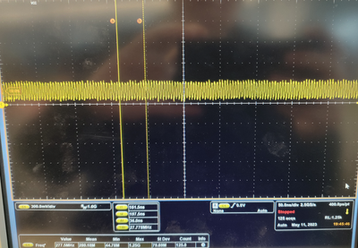

    And I remeasure the waveform of the CLK and DATA gpio of the serializer MAX96789, show as below:
(1) The CLK pin waveform:
As you can see, the frequency is 276MHz, meet my expected value.
(2) Data of High-frequency pin:
It is only 44KHz, the frequency is far below our expected value. Theoretically, the frequency of the MIPI-DSI high-frequency output pin should be consistent with the CLK frequency, so it should also be over 276 megahertz.

    After completing the preliminary preparation work, I re-measured the data and clock pins and found that the clock frequency was slightly higher than when libwfdcfg-imx8qxp-adv7535.so was not used before (previously 275MHz, now 297MHz), as shown in the following figure:
(1) Clock-Frequency Figure:
The frequency measured by the data pin is 25MHz for high speed and 45KHz for low speed, as shown in the following figure:
(2) High-Speed-Frequency Figure:
(3) Low-Speed-Frequency Figure:
(4) (High & Low)Mixed-Frequency Figure:
Due to unclear theoretical waveform and frequency of MIPI-DSI, I am not sure whether my current implementation is correct or not. Could you please check the wareform above ? Is it wareform of MIPI-DSI signal ?

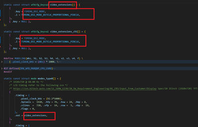

Bio_TICFSL
your measured 25MHz seems it is too low. It would mean 4.16 pixel clock, which is not standard resolution (is it 640x480?).
To tell how should look correct frequency, could you please share what resolution are you setting?
In your case, it might help to define parameter the following parameters in file
imx8x-adv7535.c:
static const struct wfdcfg_keyval video_extensions[] = {
    { .key = TIMING_DSI_HBLANKING_MODE, .i = TIMING_DSI_HBLANKING_MODE_AUTO_BYTES, },
    { .key = NULL },
Do you have access to the mentioned file and could you compile it?
I have attached pictures from developers for your reference to see how the defines change the behavior. The third image (BTA) shows communication in low speed mode.
