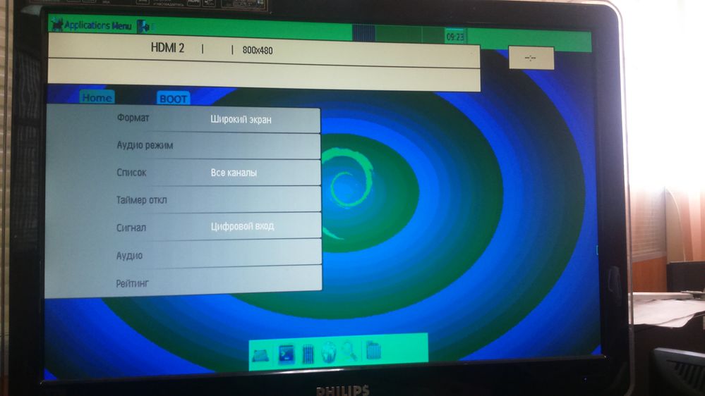

I tried to use environments from p.25:
U-Boot > setenv displayinfo 'video=mxcfb0:mxcfb0:dev=lcd,if=RGB565
video=mxcfb1:dev=hdmi,1920x1080M@60,if=RGB24' for LCD and HDMI dual displays
and as result colors on hdmi looks very bad:
and dimension still 800x480.
2,888 Views

evgenymolchanov
Hi Igor,
It is a pity that there is no ready-made solution.
In Android 4.4.3 this problem solved and it has 3.10.53 kernel and the same dts files.
I am really confused that it is so hard issue.
Thank you.
