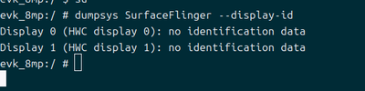

   I want to enable Dual screen asynchronous display On IMX8MP Android14。
     LVDS as the main display, MIPI DSI as the secondary display.
I get two displays:
but i get displays.lengh is 0
Display[] displays = mDisplayManager.getDisplays(DisplayManager.DISPLAY_CATEGORY_PRESENTATION);
How should I do , I use Android 14 BSP 2.2 version, Please help me Thank you!

Make sure you have added the permission in manifest, then try to use  DISPLAY_CATEGORY_ALL

I have add DISPLAY_CATEGORY_ALL in AndroidManifest.xml
bui it does not work and not found PRESENTATION Display
I can find two display devices on my board

Can you try to use getDisplays() here to get all logical displays?
