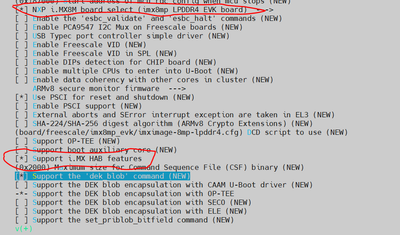

Hi @abhiroopnray
You can try as below screenshot.
1> make menuconfig,
2> enable ARM architecture for "Architecture select"
3> go Target select for your target.
4> enable HAB feature.
Harvey

Highlight "Architecture select", press <Enter>, you will be able to select ARM architecture.
Harvey

Hi @Harvey021
Can you tell me how to enable ARM architecture for "Architecture select" in menuconfig, the navigation?
