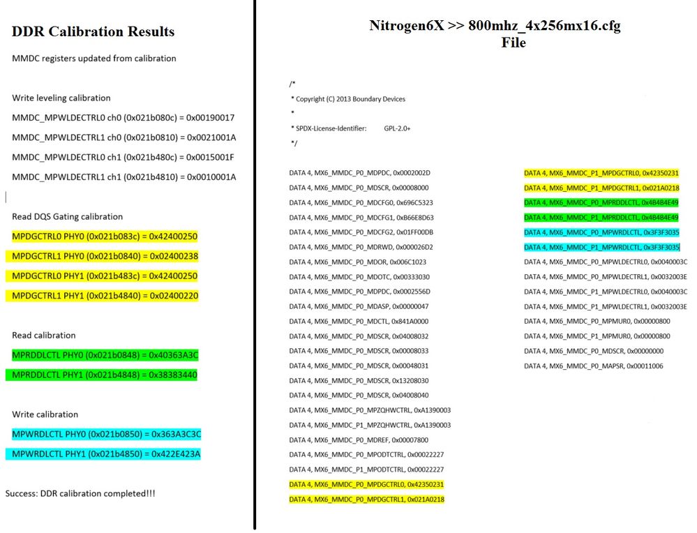

1) I have done DDR stress test and calibration using DDR stres test tool v2.60 for my iMAX6 Quad processor based custom hardware design. And I'm referring to the nitrogen6X uboot files and which files and locations should I edit using calibrations values ?
2) Initially I have an understanding about doing this according to the following procedure.
We should edit ;
# include "ddr-setup.cfg"
# include "1066mhz4*128*16.cfg"
# include "clock-cfg"
files. But according to my understanding "ddr-setup.cfg" and "clock-cfg" are generic files and we don't have to edit those files. As well as finally we need to recompile the defconfig files. So is this procedure correct ? Do we have to edit more than this ?

Please look at the following figure. Left side DDR calibration result and right side cfg file.
Is that enough just replacing the values of .cfg file with the highlighted values of the DDR calibration values ? Any more changes to do ?

Yuri
  Write leveling calibrations are not involved in Your considerations, MMDCx_MPWLDECTRL0/1

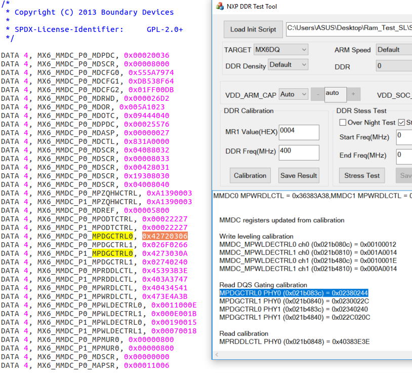

Please see the following comparison in Sabre Lite .cfg file (#include "1066mhz-4*128m*16.cfg) and its DDR calibration tool values (Skhynix H5TC2GB3FFR PBA). The values in calibration tool is completely different with the cfg file values. So why is that ? Though I run the test again and again I can get only those values.
So what I need to confirm is how I clarify the values in DDR tool is correct or not ?
Peter.

Yuri
  to verify the values in DDR tool - use them in initialization script and run tests (say, Over Night Test)
again, without (new) calibration.
Yuri.
