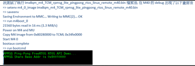

We are trying to run the test M40.bin, which will display the PRMSG message on the M40.
We are trying to run "pingpong" and load the "imx_rpmsg_pingpong",  the device cannot get any message from M core and A core.

Are you using imx8qm-mek-rpmsg.dtb?
For the tty driver, you need install imx_rpmsg_tty.ko in /lib/modules, the you can use /dev/ttyRPMSG with echo "MESSAGE" > /dev/ttyRPMSG*.
