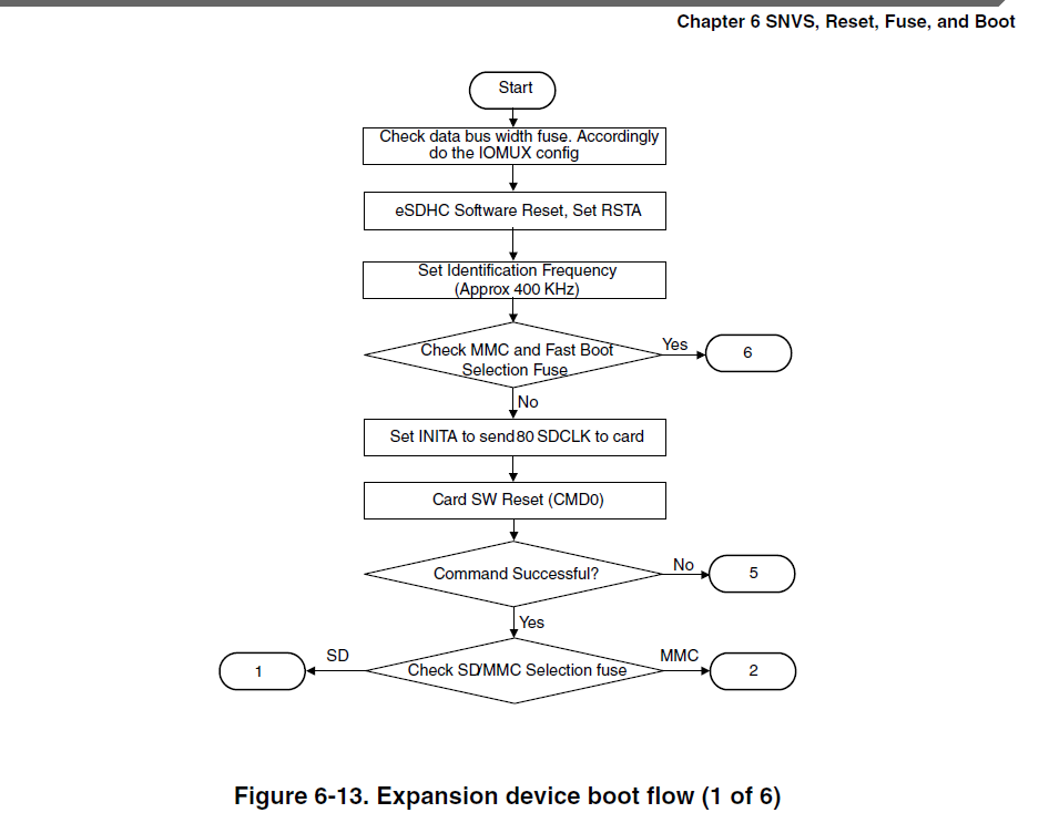

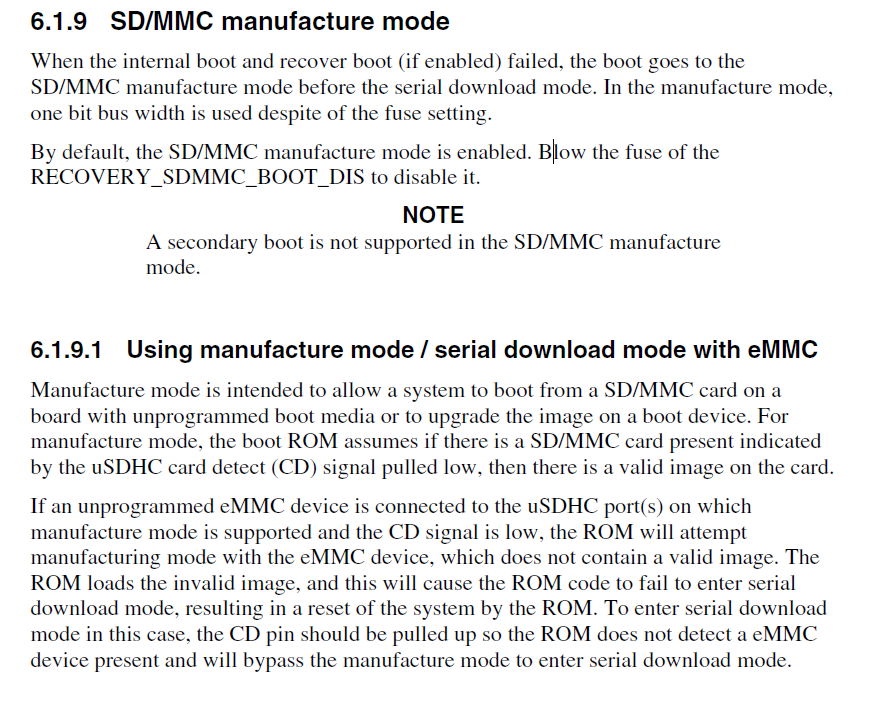

(2) Set the switch to 0x10 : It will check whether the SD card is inserted, (who will check that? you have no bootloader running at that moment. It is at ROM code boot stage)
You could not achieve that.
Because when you set the boot from sdcard . It will get boot fail if no sdcard with available image there.  And it will go to usb serial download mode.
Then you don't have bootloader and uboot running and you do not have any chance.
But if you boot from emmc fail, it has SD/MMC manufacture mode to boot from sdcard.
ROM code will go to 1 sdcard or 2 MMC.
