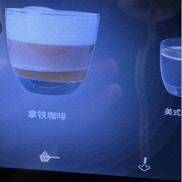

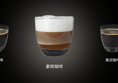

Hello all,
We hava a proble about display gradient effect, the picture shows as below:
computer display  normal:
imx6ul board display badly(RGB interface) ,the gradient  have ripples on TFT LCD:
our imx6ul board eLCDIF hardware was disigned 24 data line for RBG888 , the DTB configure as below:

I've the same problem with my imx7d-based custom board. I think it's not about timings or hardware pins, I've checked all of things for days.. it's an graphics processing issue, an software issue. However I couldn't solve my problem although I tried 3 different kernels. My 24-bit parallel LCD and Ti's tsc2004 touchscreen working fine except for that gradient trouble!

LCD displaying pictures is perfect, besides image that has gradients.

I have tried to set dpp:16, dpp:24  and 32, gradients displays not good on LCD-TFT.
witch one to decides the display effect of gradients?
any options tell to me, thanks.

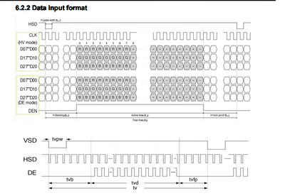

what tft panel do you use? did you double confirm if your timings settings according to your display data sheet?
2,754 Views
jerry_coffee
Yes, i have calculated timing parameters according to datasheet support by vendor.
this is our lcd reference manual parts of timing setting.

joanxie
 hfront-porch = <250>;
                hback-porch = <160>;
                hsync-len = <70>;
why did you get hfront-porch=250? refer to the data sheet, it should be 160, and where did you get hback-porch?
